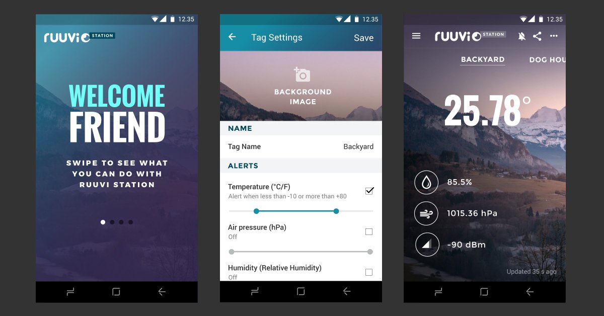

Ruuvi Station mobile app is coming:
I cannot find apk file right now. Am I need to compile from source?
Do you need APK file or app? App is available in Play Store - name Ruuvi Station.
https://lab.ruuvi.com/android-app/ page says "To try the app, look for the latest .APK file install. It’ll be available on Play Store later."
Anyway. Thanks for information
