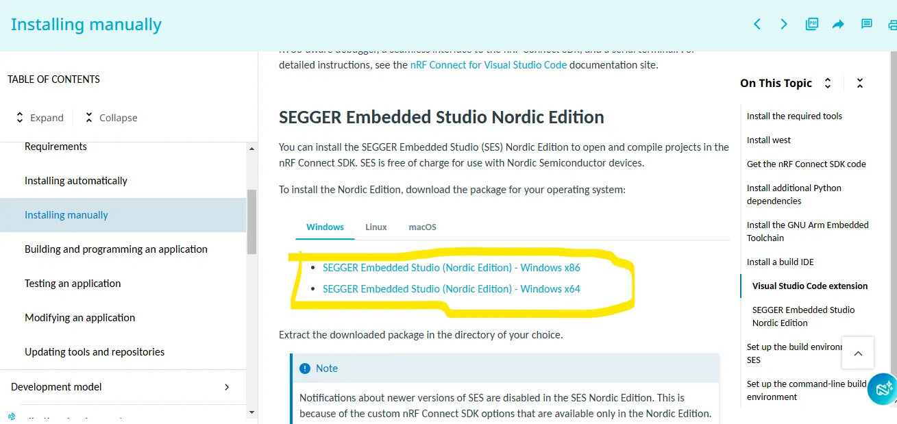

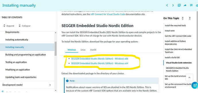

From one of the forums, I learned that some C files are deprecated in the latest Segger version (version 8), and it was recommended to install an older version, specifically version 5. I was able to download Segger for Nordic V5.68 from the Nordic tutorial on manual installation using the following link:
Segger for Nordic Version 5.68
Now, the code compiles successfully.
