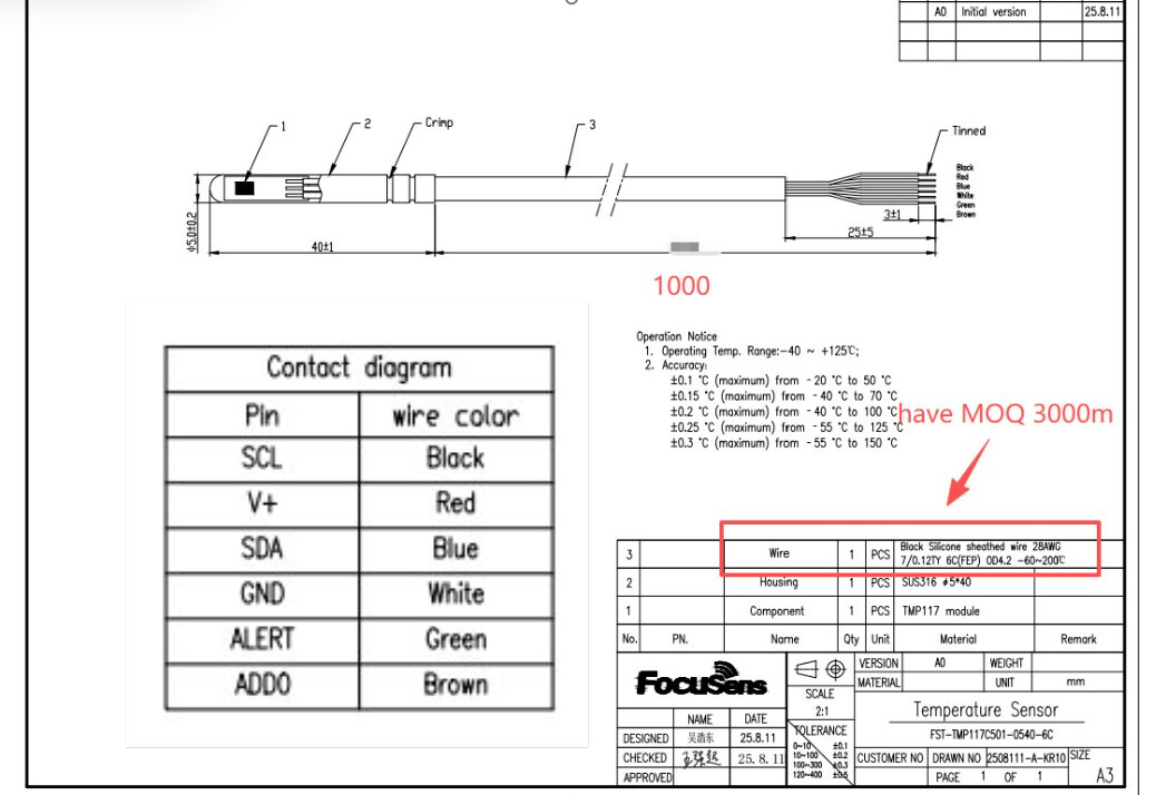

Here is the spec sheet for the external sensor I purchased from Focusens:

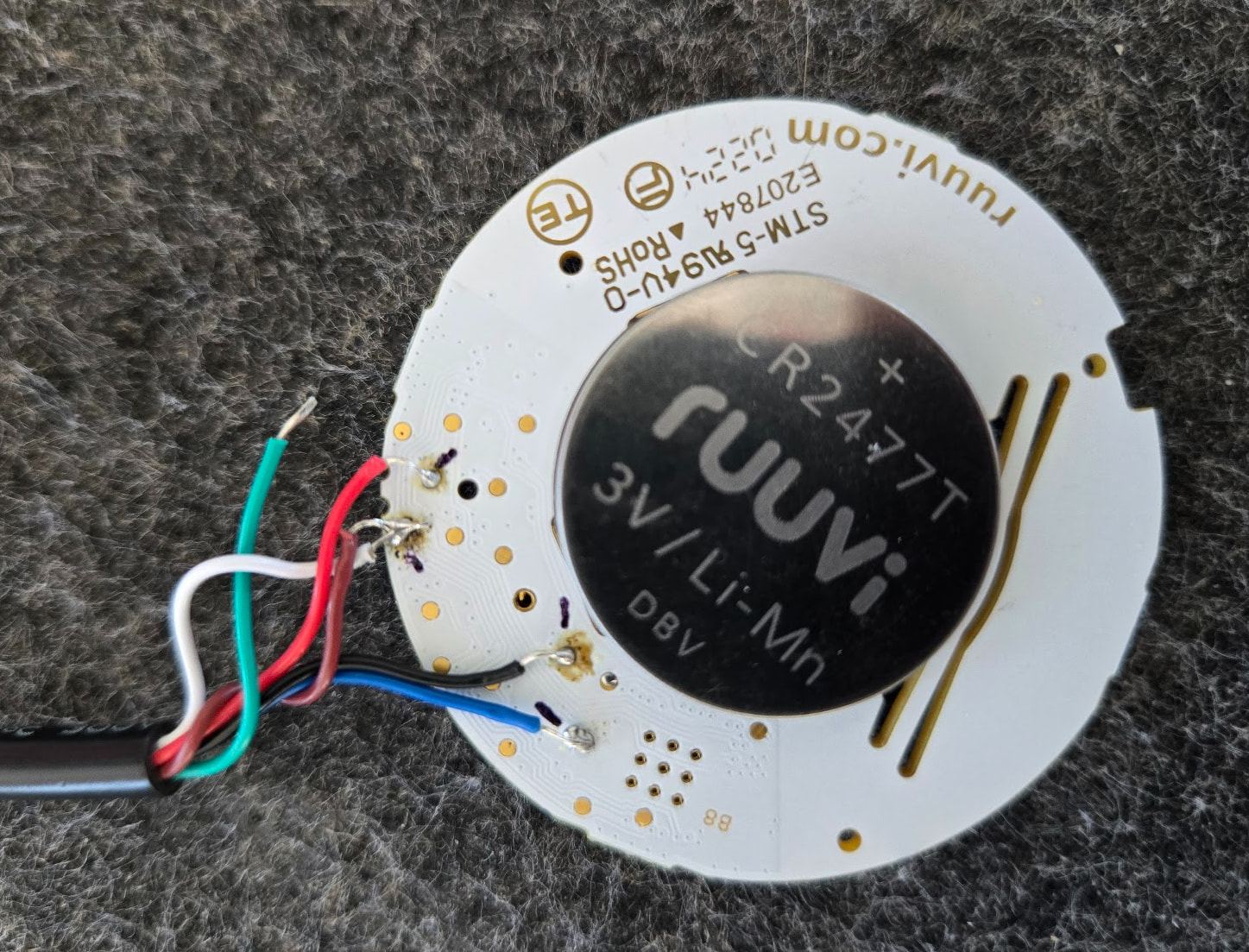

And here is the soldering of the sensor to the board. Note I chose to leave the ALERT wire disconnected intentionally.
Anything obvious that is incorrect or something I should do to correctly troubleshoot this issue?

If I recall correctly, TMP117 defaults to 0 C after reboot.
I’d check the connections, a glitch could cause reboot. If the reboot is consistently about temperature, the board might have something that does not work at higher temperature.
