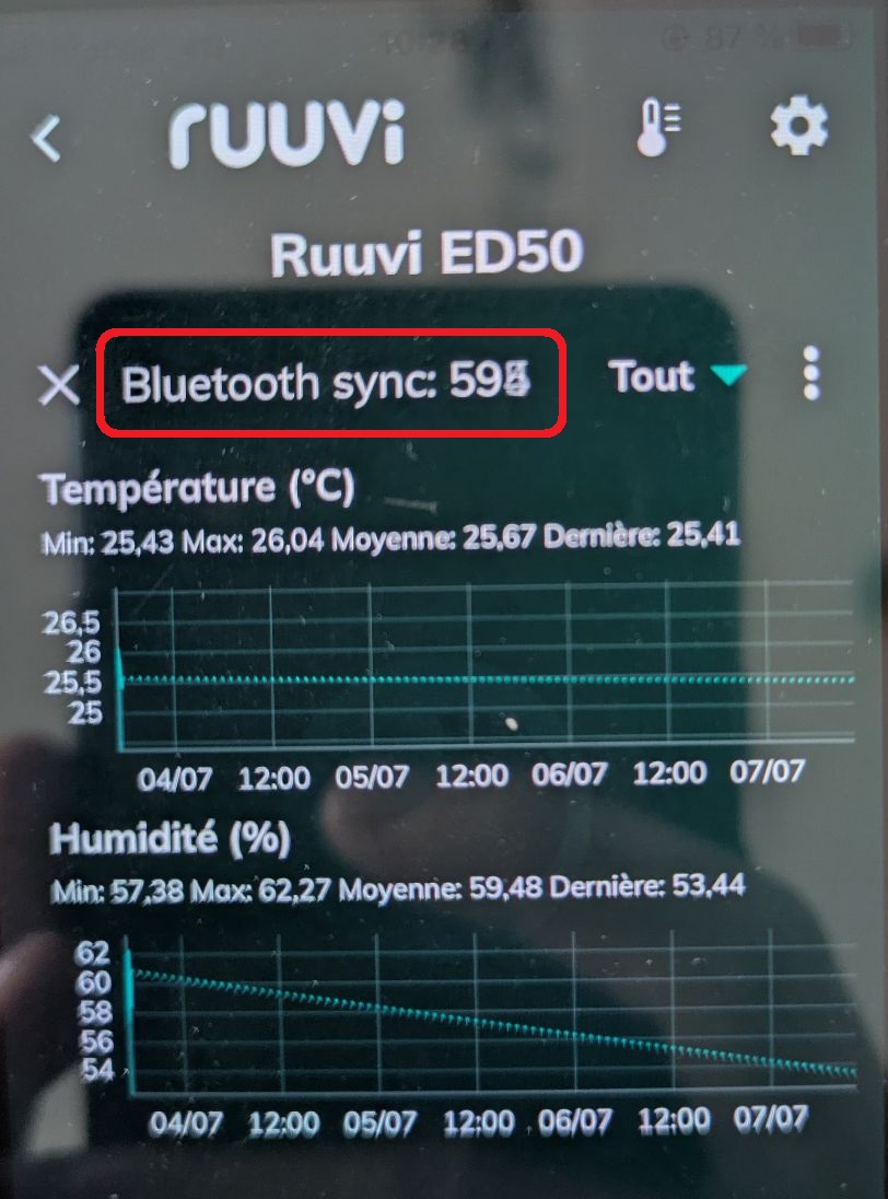

Hi all,
I am using Ruuvi Station App on both Android and iOS.
I am in front a big issue on recent iOS version and Android version with latest Ruuvi Station App.
I am not able to synchronize my Ruuvi sensor internal data with the Ruuvi Station App.
However with old -only- iOs version and old iphone is working (iphone SE 2016 and iphone 5S)
I did not make it work with iphone 16 neither Pixel 7a
Here is my test summary:
Ruuvi Sensor firmware version: Ruuvi FW V1.0.0+default
Modele O.S version Ruuvi Station version Bluetooth Status
Iphone SE (2016) 15.8.4 2.14.6 (2504111112) 4.2 OK
Iphone 16 18.5 2.14.6 (2504111112) 5.3 NO
Galaxy S10e 10 2.15.14 5.0 NO
Galaxy S10e 10 2.0.6 5.0 NO
Galaxy S10e 10 2.10.12 5.0 NO
Galaxy S10e 10 2.13.18 5.0 NO
Pixel 7a 15 2.15.14 5.3 NO
Iphone 5S 12.5.7 0.7.1(109) 4.0 OK
Galaxy Note 4 9 4.2 NO
I several time uninstall/install the App, desable bluetooth…
I uninstall the application on the iphone SE and try with only one smartphone and one app running at the same time. The results are the same: the synchronization function does not return the data on the app.
Any help will be very helpful.
EDIT: I added in the table more Ruuvi Station App version tested with S10e; Ruuvi firmware version; Test scenario.

Thanks for your message and test report. At the time of writing I have access to iPhone SE and Galaxy S10+ among other devices and cannot confirm this, everything is working for me after testing app versions, updating, syncing and clearing synced data. My RuuviTag Pro 3in1 sensor used for testing has full 10 days of data.
Did you try to do sync at same time on Android device when iOS device was still in middle of sync? Only one connection is allowed during download. What is the firmware version on this RuuviTag? Do you get disconnected popup or does the counter only get stuck?
There is a known download related issue in specific firmware version, where it can get stuck for extended periods of time. Timeout issues are resolved in later versions of the app.
Maybe the good thing to try out here would be to remove battery from your RuuviTag and then collect few days of data and see if it happens again.
Is your iPhone configured with “keep connection”? That option keeps the connection open for background alerting and other devices cannot read history. You can try disabling the background connection in app and then retry with other devices.
