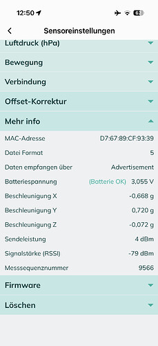

What Ruuvi Station app is showing as a voltage? Note that you cannot measure voltage with multimeter as itβs not showing correct value (needs to be measured under load).
It now shows 3,052V. I had to disconnect it from the Cerbo, as it continues to show alarms.
Where and how do you check the voltage?
