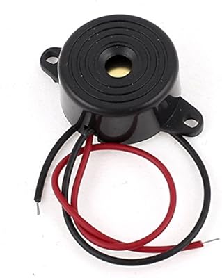

Thank you also for outlining the type of buzzer. This one seems to fit the bill:
http://vi.raptor.ebaydesc.com/ws/eBayISAPI.dll?ViewItemDescV4&item=291532850541&category=4660&pm=1&ds=0&t=1496714914000&ver=0&cspheader=1
But this one is an active buzzer at minimal 3v so no need to make an oscillator

Please note that the coin cell is going to drop below 3 V relatively quickly, so if you can find a buzzer which works down to 1.8V you’re going to have a lot longer battery life

Maybe this:
or this
https://www.digikey.com/product-detail/en/pui-audio-inc/AI-3035-TWT-3V-R/668-1204-ND/1745457
