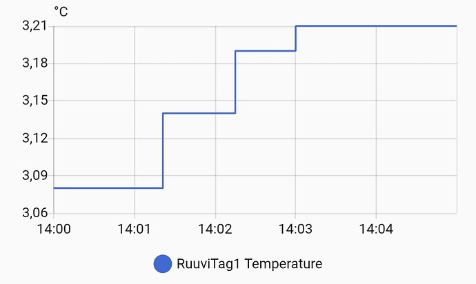

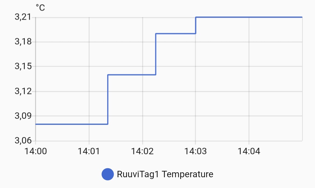

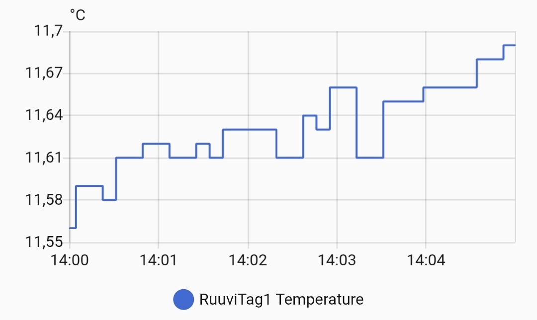

Actually longlife firmware 3.34.1 emit changes more then 1 per minute.
Screenshot from homeassitant:

Thanks you very much, now flashed, it works. Movement: 0, BT update ~53s.
