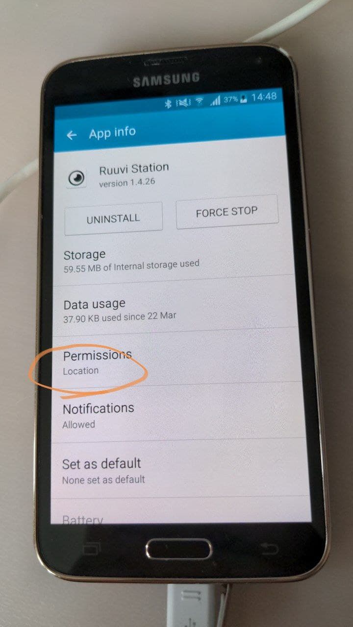

Ruuvi Station supports Android from version 5. I’d suggest to reinstall latest version and make sure you allowed access to device location. Lenovo might also have some specific settings.
Thanks for your reply. Ruuvi Station is the very latest available from Play Store, and it has the Location permission. I couldn’t find anything Lenovo specific, though.
