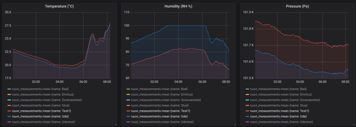

I just tested my outdoor sensor, with one of the new sensors I’ve got. It doesn’t draw well.
My outside sensor is “name: Test1”. which I replaced with the original outdoor sensor.
The new sensor that I got the other day is “name:”.
They are located next to each other.
The next thing I want to test is my sensor in the greenhouse. I have the feeling that it has also gone whistle.
To me it looks like they can’t stand being over 80% RH for a long time.
So I can’t use them in my automation as I can’t trust them.

I got some new ruuvi tags, of which I have taken one of the new ones, and first I placed it by the outdoor ruuvi tag.
The new sensor has the green color and the name “name:”
My outdoor sensor has the red color and the name “name: Test1”
The new sensor is around 90% RH while the outdoors is at 100% RH.

I have 2 new pictures where I also compare the new sensor with the existing one.

Sorry, but I still don’t fully follow the explanation. I also could not find name “greenhouse” but you probably meant “drivhus”?
“the new sensor is around 90% RH while the outdoors is at 100% RH”
Do I understand correctly that you have now placed new sensor also outdoors and old one is showing 100% and new one 90%? Both are close to each other?

"Yes both side by side.
Took both of them to the kitchen table, and opened them, took a picture. There is no moisture on the sensors.
The indoor difference in RH is 8% RH.
Yes, but in my greenhouse, I have forced ventilation that I had hoped to be able to automate with these sensors, but because they deviate too much over time, I can’t trust them.
The temperature difference of 1C is also a bit too much i would say.
