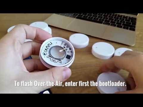

Using this guide to add Eddystone:
Zip here: https://ruu.vi/setup/packages/20170118-eddystone.zip
Apps:
nRF Connect for Mobile (used to upload zip to the ruuvi tag)
https://play.google.com/store/apps/details?id=no.nordicsemi.android.mcp
nRF Beacon for Eddystone (edit the values) the password is:
00112233445566778899aabbccddeeff
Beacon Toy (seeing the data in action)
https://play.google.com/store/apps/details?id=com.uriio
(pause it 1 minute 25 seconds into the video)
